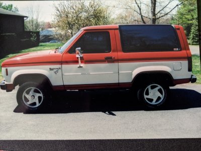

Ok, I need new tires. I'm not racing the car, or doing any insane handling tasks. Back in the day I had 295 50r15's on 15x7 explorer wheels on my BRONCO II. I drove it in this configuration for years, and never had a single issue... Mind you I was in my 20's and took corners with reckless abandon. Again, not a single problem.

When you had those tires on the Bronco, with the 45 degree sidewalls on the skinny wheels, that vehicle didn't have anything resembling "handling", not by any current standards. But, those Broncos were never set up for handling.

Fwiw, I had no idea what I was doing when I put them on the bronco. I saw a cherokee at the time that was at a car show with 295s on stock wheels and thought it looked "cool", so I did the same lol.
