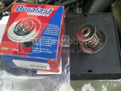

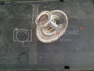

so i got my new thermostat looks to be the same as the one i had in there. difference is in the design it looks different has an added piece, is this normal?
new:
2012 11 08 163224
old:
2012 11 08 163244
