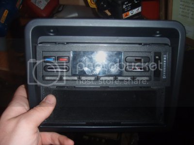

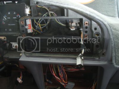

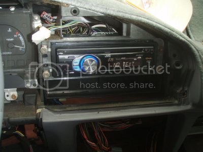

Okay so right after I posted this topic I couldn't wait and I went for it. Here are my results :]
Wires and Lines are swaped around.
P1014679

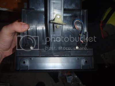

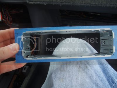

PlexiGlass piece my dad and I made to hold the radio.
P1014685
Radio's Working

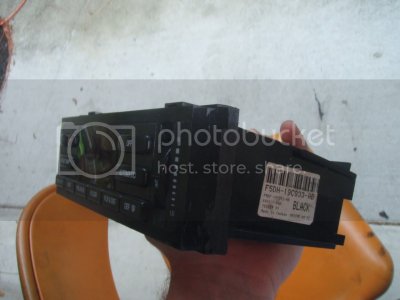

Using my old EATC with broken buttons for practice.
P1014691
P1014692
Cut the sides off the new one.
P1014694

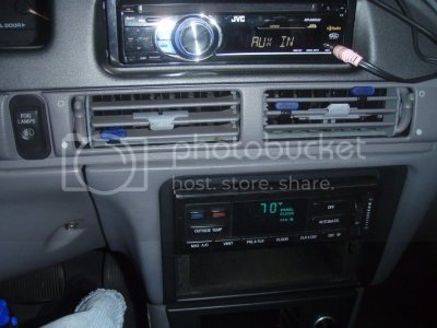

Finished Product.
P1014703
It's much nicer than reaching way down to changed the volume. :)
Any tips on making the EATC fit/look better?
