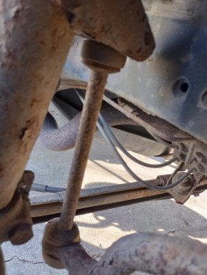

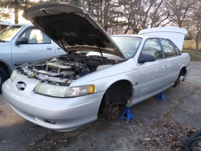

So I'm having a bit of trouble with these subframe bushings and sway bars. This will be my first time doing these things so it's a little frustrating and intimidating given my lack of experience and the fact that I don't have access to a lift. I've read the subframe bushing replacement sticky thread but that was a bit vague, and this repair manual I got is almost useless. I also broke the stud off the end of what I assume to be the rear endlink and can't find the replacement on sho source. Has anyone written a more detailed guide for this?

You can buy replacement endlinks from Rockauto, Napa, etc. If they snapped off, you are better off replacing both of them.
13,266
With the rust under there you are going to need long cheater pipes or breaker bars (or air tools) to get those subframe bolts off. zoomlater is correct, you can find endlinks anywhere. You can wrestle with it or tap it or cut the rod again and tap it up and out the top or bottom. It's just a rod with 4 bushings and a nut on each end to hold it in place.

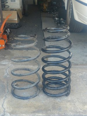

Here's the skinny on spring rates. Note how much softer the Taurus springs are:

Forgot to explain the pic of springs in my post above. Stock spring on the left, quick strut spring on the right. Note how much taller the right one is, and therefore how much it gets compressed when installed.
