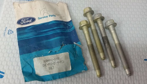

Does anyone know the dimensions of the subframe bolts oem or know where to find oem subframe bolts for a 1995 ford taurus sho mtx 3.0l?

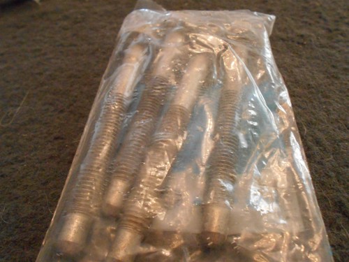

The Ford part number is -N804442-S150
You can still buy them new at Green Sales in Cincinnati. Just Google them for info.
A very common mod is to swap the SF Bushings on the Gen1/2 with the rear bushings from the Gen3. When you buy Gen3 bushings they come with new bolts.
-Chad
Screenshot 20230318 132027 Chrome
13,265
just bolts
