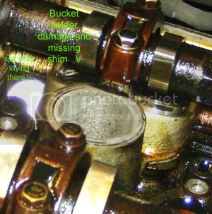

I just pulled the back valve cover to take a look. Ill get back to you guys after I take a peek there.
I also have a spare DIS sitting around here somewhere, I'll give that a try after I reassemble the top end.

Well, the valves all seem to look good to me. The center cylinder in the back of the engine seems to be the culprit, at least it looked that way by looking at the plug. I wonder if the plug just died? I have NGK plugs in it now. I'm going to go get some more, and new plug wires also. Hopefully I can get this narrowed down.
