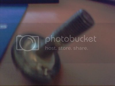

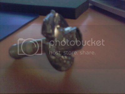

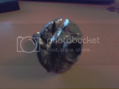

A day and a half leads to success! :sun:
Tools used:
Air chisle
1" hole saw bit (3)
Dremel
Air Dremel or whatever its called!

I doubt it's crank cancer, just replace it with a crank bolt that's in decent condtion and you should be fine.
