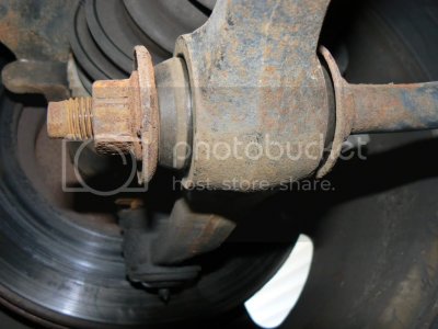

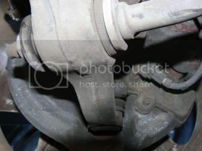

Ok.. since I have 2 sitting next to each other, I looked at both....
Here is the 92... with the "new" lca's...
P1060897
P1060900
I would imagine that shiny line (not the far left, but the one next to the LCA) is what is squeezing, and or moving and causing the movement.. thats where i can feel it when I push the car back and forth... that washer, getting closer. then farther away from the LCA... Almost looks like it shrunk or something.. I dunno.. I don't know if I have a pic of them when I got em..

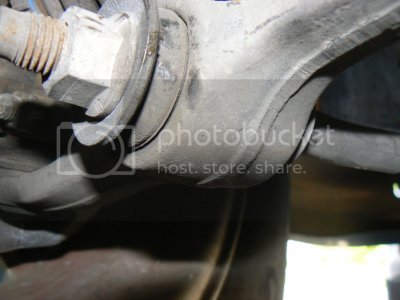

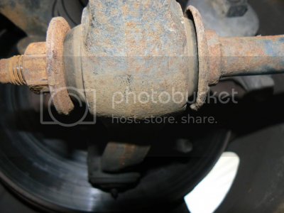

And here is the 93's with its stock setup...
P1060902
P1060905
Call me crazy, but the entire arm, and bushing is larger...

the washer in your last pic is your answer. the really thick heavy duty washer in your last pic in not in your previous pics. either double up washers to get close to that thickness or buy a couple flat washers and drill them out to that size to shim it tight.
it is tough to see in my pic but I also have that thick washer in the front side of my strut rod bushing.
