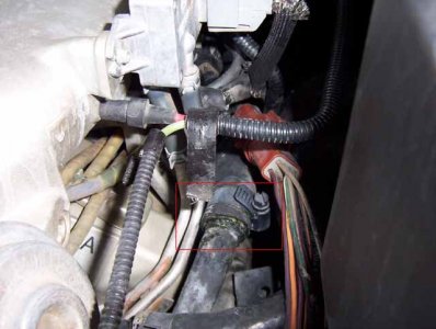

I checked around for vacuum leaks, following the info you gave, and generally looking around, and couldn't find anything except for this one questionable hose, that I'm having trouble identifying:
Hose

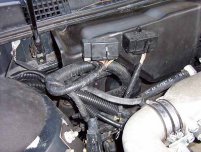

And also a hissing sound coming from this area (to the left and behind the engine), but it's too cramped to tell exactly where it's coming from without further investigation:
Hissing
Is it possible that instead of a vacuum leak, it's a problem with my fuel system or engine control causing the lean condition?

That is a coolant hose going to the heater core, not sure on flow direction. Have you checked the IMRC (int. man. runner ctrl.) vacuum reserve canister for signs of damage or cracks? With the engine off I would plug the vacuum source for the IMRC, you should have full power from 4k to redline if this is the cause.
