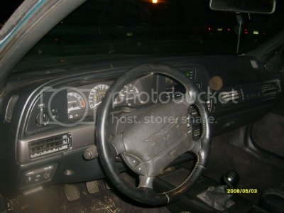

this is from a 95 t bird. you can use your taurus airbag instead of the ugly t bird one. notice the small parts next to the airbag that arent on a taurus wheel. this is the part that i like.
