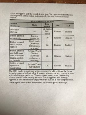

So all three functions work? TC OFF, SPORT MODE and ADVANCETRAC OFF?
Do you have the ability to pull the cluster info?
See if it is part # DG1T-10849-EJ with software of DG1T-14C088-BH and DG1T-14C026-BJ.

Sport Mode is activated by the gear shift.
I press the button once, TC is turned off. I hold the button down while depressing the brake for 5 seconds the AdvanceTrac turns completely off.

Double tap is Advance Trac sport mode. It dials back how the car intervenes.

I tried this and it didn’t work for me. So much for my non-PP to act like this. I will try to install the switch and see if that works. Anyone ever hear of installing the PP software on a non PP vehicle?
