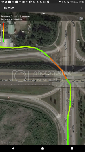

Is there a way to look at data logs to see if your car could benefit from colder plugs I'm running a boostmax in the logs it's maxing out the map sensor so no idea how much boost it's actually doing
Looks like I've got some good timing advanced instead of negative
Screenshot 20170527 082932 zps9co76gjn
This is peddle to the floor in sport traction I was pulling .96g when tires started to slide but seems traction control didn't step in
