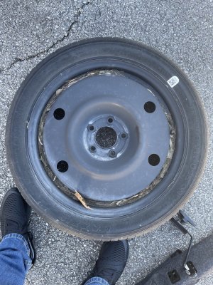

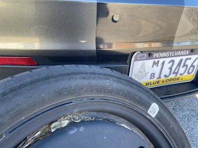

My non pp spare is 145/70r18.
Never installed it so i cant confirm it fits. Pulled it out of my car acouple months ago.
Should be the same as pp, nothing different on inner mounting size between the 2
