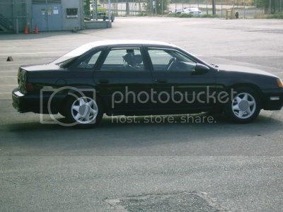

I am not 100% sure about the lowering. I am the 6th owner of my SHO and I dont think it has been lowered...but to me it looks like it rides low in the rear.
Anyways thanks for the tips on getting rid of my mooing cow.
Think my SHO might be lowered?

The rubbing inside the strut tower can be silenced by a dose of silicone grease or spray at the contact point near the outboard portion of the inside top of the strut tower.
13,265
Don't know about spring costs but you can do the work yourself. It's not that bad. The springs sag in the back of these cars over time. It should still ride ok.
