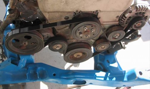

My belt is already routed without the A/C and the idler pulley between the water pump and altenator is also gone (is this bad?).
Assuming you have a 3.2 with one belt...
If you mean you went straight from the alternator across the water pump to the p/s pump, then you've eliminated most of the wrap (i.e., the amount of belt that contacts the pulley) on the water pump and reduced it quite a bit on the alternator. Other people have done this, too, and gotten away with it, but it increases the chances of the water pump and/or the alternator slipping. I left the idler in as I don't want either to slip. Ever. ;)
Like this:

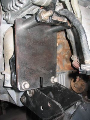

No I want to take the A/C compressor, housings, and hoses out, but dont know what to use to keep the motor mount supported. I also dont know what can and cant come out.
Phoenix' pic shows how to keep the gutted a/c compressor in place to support the front bracket.
I used a plate instead, like this:
