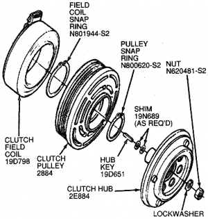

Perhaps the AC compressor magnetic clutch cycling, which is standard operation of the AC.
1716337366195
It can click on under every 30 seconds while it is running in cool temperatures just as a dehumidifier.
Ac clutch1

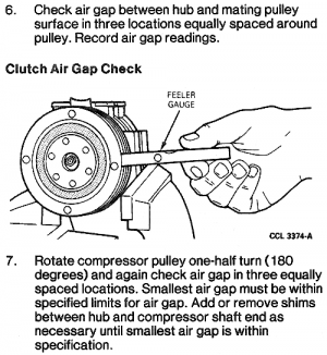

You can check the gap between the pulley and the front clutch plate with a feeler gauge, which should be 0.021-0.036 inch.
The gap is adjusted by a stack of shims. If too large, you can remove the shim closest to the thickness needed.
