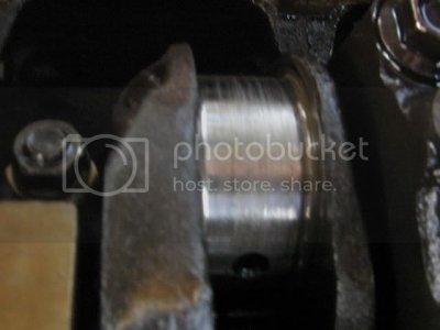

How bad is the crank? Does it look like this:
6921

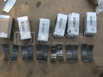

bearings:
6929
I was able to polish it smooth, but it will still pop on the pressure light when hot and lugged, as will happen in heavy traffic. It did take a while though...

You would basically be "rolling the dice" on the motor if you just patched it up and put it back together. Could be fine or it could die a week down the road. If you are replacing parts in the rotating assembly it could unbalance the motor....which isnt a good idea when you are reving it to 8K.
7,521
when you spin the bearing, not only do you score the crank, but you also make the rod end go out of round. the result of a 'patch job' is that it will spin the bearing again soon, likely very soon.
