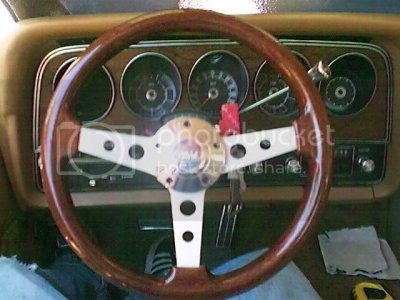

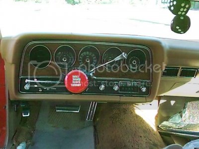

Ok, now I know this isn't exactly 'legal' on an airbag equipped vehicle, however I see tons of Hondas with aftermarket steering wheels/airbag deletes. I give to you the Grant Vehicle Security System:
PIC 6649
PIC 6643
All I have to say is when they broke in/tried to hotwire the van they did not touch the Torino at all becuase there was no steering wheel. I take it out every night and whenever I am in a parking lot with public access other than my work, or if I will be out of view of the car for an extended period of time.
Even with the steering unlocked it is difficult to steer at any decent speeds (above 10) I have driven mine w/o the wheel before to repark it, wouldn't try it again. It works with any 5 bolt Grant wheel, and other brands can work if you can find an adaptor.
