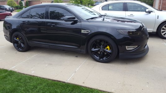

Hmmm, I think I know the part you're talking about, but I believe it is silver on mine. The lights sit in a silver piece on my 2010. Here's a pic of my car, if you could clarify what piece I need to pry, it would be greatly appreciated. I'm far from a mechanic, so sorry about my lack of knowledge haha!
27407227367 a4513156c4 b20180521_163320_1526934837485 by John, on Flickr

Also, if it is not the silver piece you mentioned in your last post, will my chin spoiler have any effect on prying the part I need to pry lol?

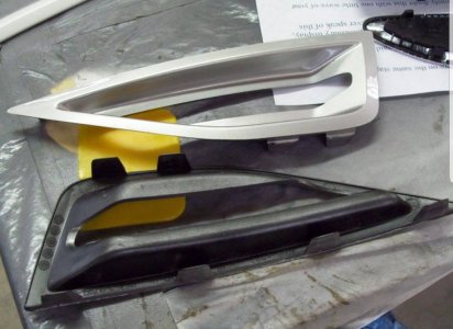

If it helps any further, here is an image of mine, off my 2010, removed many many years ago now, to be painted / color matched to the OEM Tri-Metallic White.
Viewed from both the front, and more importantly the rear (so you can see the tabs everyone is describing).
Finally, one suggestion I haven't seen posted by others yet, is that I would STRONGLY recommend using a hair dryer, or a heat gun (on a very low setting) to warm up all of those tabs prior to going at them for removal.
Doing so will make them more pliable and less prone to breakage.
Hope that's of some help. Good luck!7f1c243e6cba8f19886dd1ed0a472fe0
