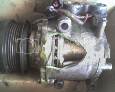

This was a couple months ago but I ended up replacing the AC compressor after it went boom. It was quite a bit of labor but was straight forward work and not too hard to figure out. Obviously some of the right tools make a big difference. I installed it and then had a shop blow out the lines and everything and recharge it, total cost about $500. Better than the $1100 I was quoted from the mechanic.
I've never seen a compressor blow up like this before, it started making a loud ticking noise (at first I thought it was the engine) and then boom!

Wow.. that's crazy. I didn't think the ac compressor built up that much pressure inside of it.
Kinda cool to see inside of it though like that.
