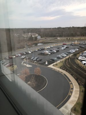

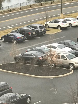

0e4c2cf18cd4bf5eeaa5206629d119857d8fb0b8ed5f7962e31b9634146c8617
Pretty good distance from here. Just started, gotta be in the 3-500 foot are. Probably bc I'm on the 4th floor
Very similar for me, I'm on the 3rd floor and my car is on the top deck of a 2 floor parking deck, no problem from the window for my 2016 SHO.
