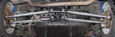

Or for only $400, you could get our Original Aluminum Control arms.
I had looked at those but was not sure on the adjustability.
How adjustable are they?
I would also like to be able to move out the rear wheels to fill out the rear wheel well a bit. Paul Nimz had mentioned this ability with the GM arms in his write up on V8SHO. The fact that the wheels sit in so far on the back bothers me. I would like to be able to improve this along with improve handling a bit.
