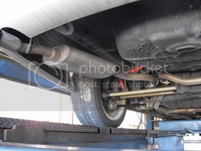

great buy from sho source, fit right in without problems
good price, new bushings and not some 175k mile used GTP ones from a junkyard....
no modifications needed, other then the brake bias issue, but thats with any aftermarket control arm
heres mine from SHOSource, ingalls arms painted, if you want to see any other pics of them installed so you get the feeling of what they are like on the SHO, let me know..... these things are VERY sturdy... heavy.. but strong
