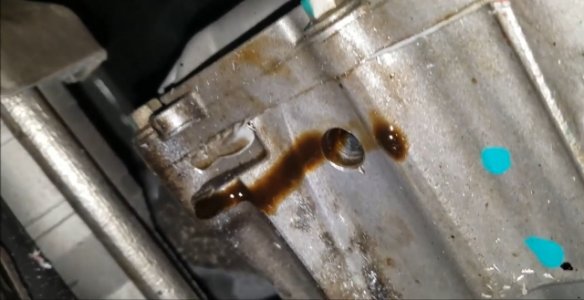

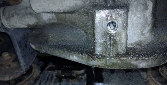

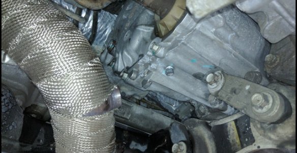

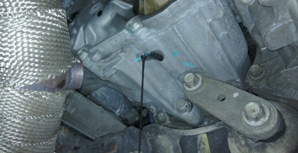

This is for the PTU. 1 inch in front the seam where the case COVER meets the HOUSING. I've drilled 3 of these in this location.

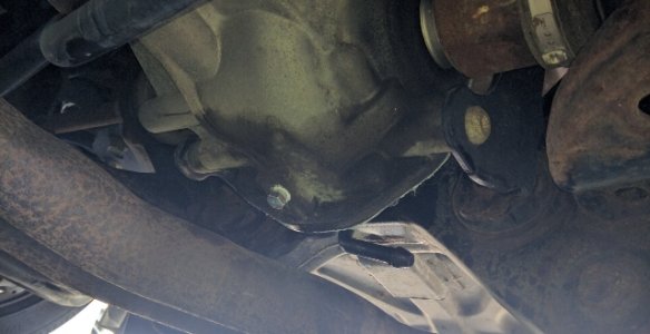

The RDU can be drilled right on that case rib.at the bottom rear.
I wouldn't worry about aluminum shavings too much. The hardened hypoid gears will emulsify the very soft aluminum to the point where its more of an antiwear additive like zinc. The gears wont even know its there if there's just a small shaving floating around.
Plus I always run some brakekleen or atf thru the sump to drain out any sediment or shavings.
I use the same drain plug that our transmissions use. It's a 1/8 27 NPT.

I usually drill it with the gear oil still in the sump, with the bit poked through a plastic bag to shield the drill. But you can extract most of it before drilling if you wish.

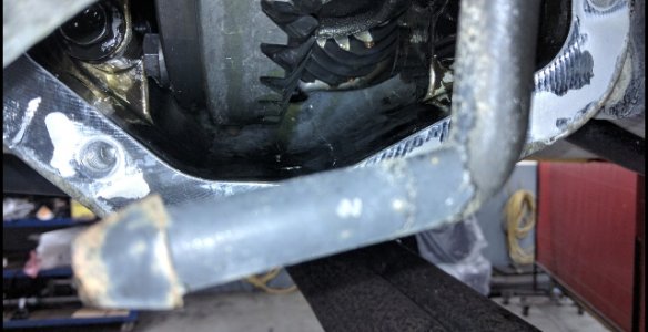

The pics here are from mine in 2017 when I drilled the plug. I extracted 10oz of fluid and filled it about 7500miles before installing the drain plug and taking these pictures. I flushed the sump. Reflilled. With Amsoil 75w110. This was 2017. 20k miles later oil still looked clear as the day I put it in.
The RDU was done in 2016, fluid had 100k on it in and look brand new. But that cover was a PITA, lowering the exhaust, cleaning the surfaces of the diff with little clearance between the subframe. Arrrrggggh! So I drilled for a drain plug to ensure I would never have to do this again.
