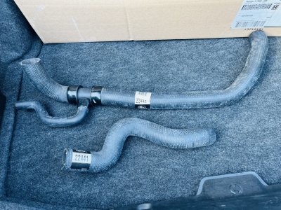

IF you need upper and lower radiator hoses, you better order them from RockAuto soon since they do not have many available. At O'Reilly's, they have none. I'm taking mine in on Wednesday to have them replaced. I'd much prefer to have the hoses changed FIRST before I order the shocks. The upper hose in my sedan now is very soft. I'm just waiting for something to happen to them.

Agreed. Those soft hoses can leave you stranded.
I am starting to work with a vendor to put together a Taurus/SHO Gen3 specific silicon set. Which hoses are you looking to replace? There are some hoses that are unobtanium. You can work around that in many cases with off the shelf stuff, but I recall the split water pump one I had to find by looking at different vehicles in the past. And those that go to the oil cooler from the block to the pump typically aren't available.
Just starting things and need to get some actual OEM hoses to make the complete set.

I’m just ordered the upper and lower hoses. Nothing else at this time.

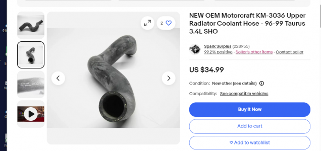

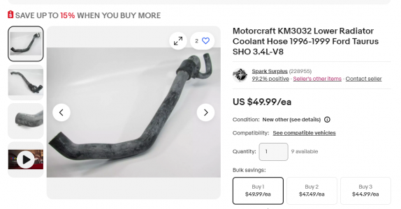

is this the correct number for the upper radiator hose?
NEW OEM Motorcraft KM-3036 Upper Radiator Coolant Hose - 96-99 Taurus 3.4L SHO
Since we can't post ebay listing except in the SHO Finds section, you can search ebay using the description above to get to the Spark Surplus listing. I have bought a bunch of stuff from them. I have found you need to double check the part numbers they list to be sure they are correct. They also have some other Gen 3 parts listed there as well, just search for SHO under their "Other items"
That looks like it will work.
This is a common problem. I have ran into this a lot with O'Reilly's and others. It seems their catelogs are using a similar sources for parts lookups and many things are defaulting to the 3.0L versions such as the A/C Compressors, Alternators and Coolant Reseviors. So its always best to double check.
For the main hoses they are similar as the upper will want to have a bend to get past the battery box. Unfortinately most do not come with any heat protection to protect the battery box. I've seen problems with this in the past. The OEM had a metal clip shield that would provide enough seperation. I've successfully used nylon heat shielding (sometimes this is included).

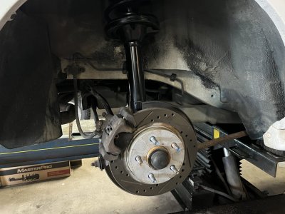

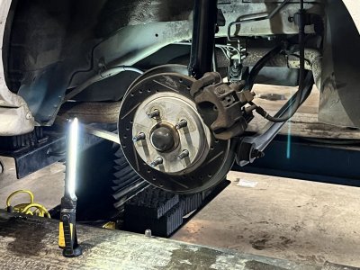

They are replacing all 4 shocks/struts right now.
