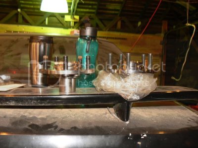

P1000297
There is your difference in stud length... no real extra threads, but its easier to get the nut started..

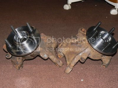

One of these are about to fail.. can you tell which one ? lol
