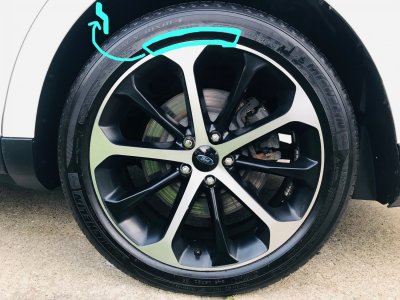

It's time to replace my stock 245/45/20 Michelin Primacy MXM4 tires at close to 40K miles (original set) on my 2015 SHO.
Dealer has said Primacy is only available in 255/40/20 now (not worried on small size difference, I know these will fit) but also thought they were discontinued. Michelin told me they're active and no plans on discontinuing.
What I really like about the tire is the aesthetics of the sidewall, along with the fact they've done me well for when/where and how I drive.
Does anyone know what produces that negative, or almost 45 degree angle incline back towards the seal near the lip of the rims? Is it simply the byproduct of running a 245 tire on an 8" rim?
I've tried to look for some similar tires just in case I want to stick with 245/45/20 if the MXM4s are in fact discontinued. It looks like Goodyear Eagle Touring or Michelin Pilots produce a similar look/sidewall.
Does anyone have any recommendations based on what I've mentioned above or some pics of their tires that produce a similar aesthetic? Does anyone run the 255/40 Primacy MXM4?
Thanks all!
Thanks all!

Also https://tiresize.com/wheel-offset-calculator/ to see why the tires look a little weird.

Those pictures are a 2015 Limited. I am curious if you have the window sticker for your vehicle. Does the listed wheels match what wheels you have? At the dealer, someone may have bought a car and wanted different wheels or tires. (For example someone wanted the Limited with the wheels or tires that were on the SHO or vice versa.) Are your tires V speed rated? The 255 MXM4 is only a H. Are you sure you have the Primacy MXM4 or are they Pilot MXM4? The Pilot MXM4 was discontinued and may be the source of the dealer saying that the other size is going to be discontinued. The Primacy and the Pilot have different goals. The Primacy is more concentrated on a quiet, comfortable all-season ride. The Pilot is a more performance oriented All-Season.

Personally, I am running the DSW06+. I am in Ohio (Michigan transplant). I run the 255s rear round and have not had an issue. These are actually my second pair on this SHO.

My picture in the first post is of my actual rim & tire (Primacy MXM4 and V rated). I didn't even consider the fact that those 255 MXM4 are only "H" rated but yeah the only 20" MXM4 they currently produce. I've been so OCD on this that I saw Primacy had both the MXM4 and MXV4 (they cite the V4 as more of a family minivan and crossover friendly tire) and I've seen where the MXV4 has been listed as discontinued (that could've also caused confusion at the dealer).

The DSW06+ has a rim protector to aid in preventing curb rash. It is more pronounced on my car because I went with the 255.Combine that with the fact that an 8.5" rim is the minimum "recommended" width for a 255 and my tires are tapered VERY slightly. The 245 recommends a 7.5-9" wheel and is more of a traditional fit.
