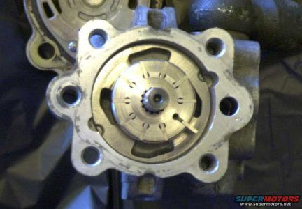

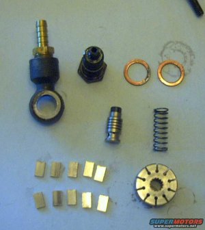

The pumps are pretty simple and there isn't much to go wrong with them.
Ps pump vanes
Small ps pump parts

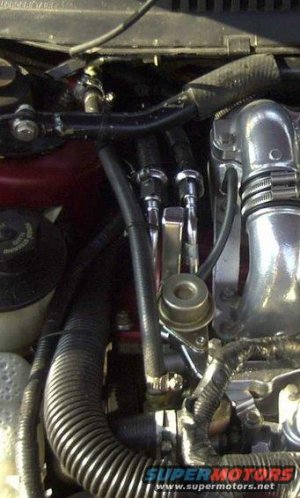

I put the hose barb in there to eliminate the pesky Ford rubber ****** thing. Using a 3/8" compression fitting on the steel line at the rear of the intake using hose clamps and steel reinforced hydraulic hose.
New ps high pressure hose
