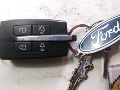

Is it possible to program the 2011 SHO wll in one FOB yourself if i bought one online? I dont want to go to the stealership 8e0974eb85a61ae34a2a57d387816607

If you only have one fob, the answer is for sure no. You can't do it yourself.
You may find a lock Smith with the right tools.

MIGHT be able to do it with Forscan for Windows, but have to follow the instructions on their page carefully. Best bet is dealer or a locksmith with access to IDS. If using locksmith, make sure they actually update the PATS table, not clone the key. Cloning is cheaper, but effectively only one key is usable at a time.
