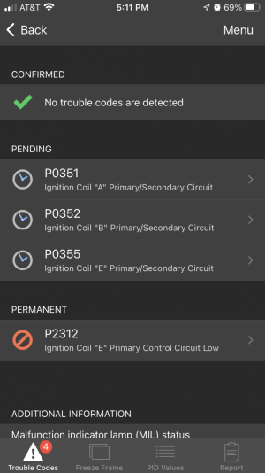

I start it today still running like crap missing awful; check the codes, now I am getting three new codes; P0351, P0352, P0355. I pull # 1,2, and 5 coils and plugs and clean everything down, no apparent cleaner damage however the plugs look like they need replaced, will be ordering and replacing all plugs next to try and get this figured out. Assuming plugs is the answer since #5 is a brand new Motorcraft coil. Fingers crossed.

Update: Took SeanDev's advice, used a garden hose to lightly rinse off everything. It looks much less "saturated" from the chemicals. I have since replaced Cylinders 2,3,4,5 with new spark plugs. Am now getting errors P0353 and P0355; which indicates #3 and #5. :confused: And also it picked up P0300 which is "Random/Multiple Cylinder Misfire Detected".
Starting to think I need to replace all coils? Possibly double check the gap on #3 and #5 sparkplugs? Not sure why coil #5, with a good plug and new coil is not working.
Also notice while running and missing; it smells of gas, super rich; assuming this is from the misfires not igniting fuel.
Any suggestions would be appreciated.

The only time I've seen coil damage like what you posted was on a dodge that had the coil control circuit grounded. Coils are all fed B+ and saturation is controlled by pcm grounding. If that circuit chaffes and grounds it essentially turns the coil windings into a toaster. I'd look for common ground circuits related to the issue, or if it's opening a common b+ circuit.

Goofy thing with Ford is one bad coil can send signals to all other coils. I had a coil literally explode in my SEL "cheap Chinese crap" and took out my PCM. Best to replace everything, coils and plugs as a unit. If still getting codes, your PCM could have taken a hit.

Yes, it ended up being the PCM. After replacing all plugs and coils, #5 was always misfiring. Checked the signal wire of #5 with a multimeter, with the car off and it was always hot. Used FlagshipOne to get a reman PCM sent out, installed and after getting the parameter reset done it starts and runs perfect!
