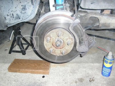

Stock '95:
BrakeComparo3

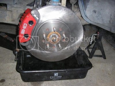

13" Cobras:
BrakeComparo4

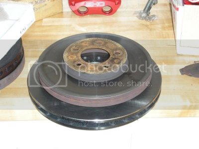

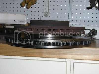

I had to compare the differences in rotors:
BrakeComparo1
BrakeComparo2

Are these "offshore" 13" rotors ? They seem thin ....:oogle:
Any brake upgrade is an improvement, but be careful of these rotors warping quickly.

I have a set of 'offshore' rotors that were $52 cdn (which is DIIIRTT cheap up here) and haven't warped them yet. And I am not known to be easy on my brakes...
