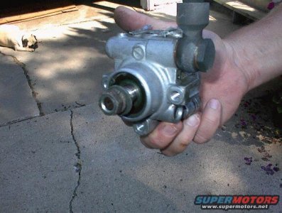

Here's the pump and the fitting I am talking about.
Ps pump front

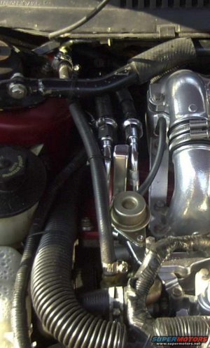

I just tapped the banjo fitting with a 3/8" npt tap and screwed in the hose ******, no drilling required. Then used some hydraulic hose and a hose clamp to secure it there. Cut the steel line as it goes down behind the engine and used a compression fitting to connect the new line to the old.
Ps hose splice

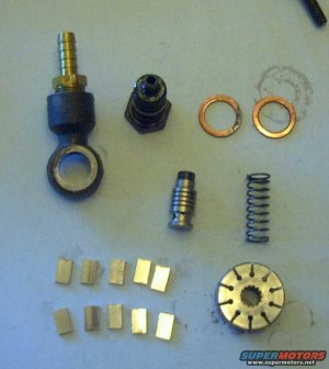

Small ps pump parts

in that last pic...what's all the shiny shit and spring and stuff?

That's the guts of the pump. The thing standing ***** next to the banjo bolt fitting is the "bolt". It sits in some sort of a flex fitting when it screws into the pump and is a POS.
