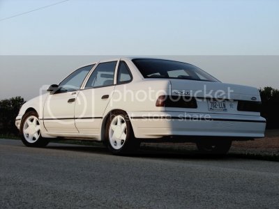

White slicers FTW!!:thumb:

Ive had mine PC for 3 and a half years....driven on like any other SHO owner. No problems, clean up nicely and look great.
