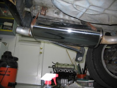

This is a 3" crush-bent exhaust, Sho Shop Y-pipe, bullet-style straight-thru resonator and a 5x11x22" Magnaflow stainless straight-thru muffler at the exit. Car has cams, 80mm MAF and the stock airbox...
I had a dynomax catback before -- this sounds better; only slightly louder, but much more consistent and zero rasp.

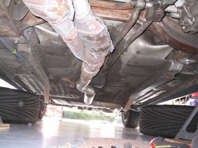

Really though it's mostly just a low drone from the exhaust perspective (you can tell this after the car goes by). It's not intrusive in the cabin -- I drove the Seattle convention and back without any interior and at cruise the thing that is loudest is the road noise and then the wind noise... The car doesn't get loud unless you're on it, which is the way I like it. I've ridden in SHOs that sounded better from the inside -- a guy here in the Bay area with a full Sho Shop exhaust has a really nice sounding cammed 3.2L car ... from the inside; the 4k crossover sounds really good. However, from the outside it is raspy and it drones too much at cruise for my liking, even with a catted Y-pipe and a resonator. I think the key to getting rid of the rasp is to have a larger case for the final muffler. Mine would be considered overkill by most people, but does the job :) I would never put a straight-through style muffler on unless it was at least 18" long.
I had some rasp when I had headers on (no cats), but with the factory manifolds and a catted Y-pipe it is completely rasp free, even when cold. A few pics of the exhaust:
2910311719 495fd8904a
2910311585 458304cc72 o
No, it's not pretty ... but it doesn't really matter :).
