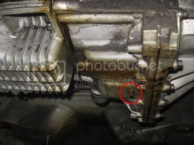

This photo shows the MTX drain plug location, as installed per the shotimes.com instructions. Please ignore the oily mess, leaking rear main seal; now fixed. I tried Valvoline Dex/Merc fluid from NAPA after recommendations on this forum, and I am very happy with it. Shifting is much smoother than with Mobil 1.
MTXdrainplug

I do not have the aftermarket drain plug. I did drain it through the one that is on the lower side, got out 2.5 quarts. I hope I didnt mess anything up by doing it this way, I drove it afterwords and it goes into gears smoother than before, guess nothing moved?
