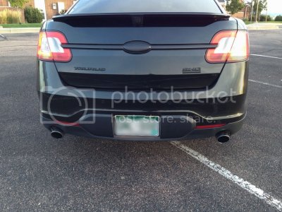

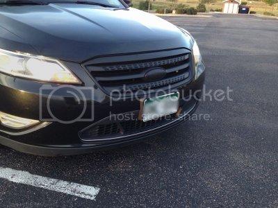

Like the look, I'm thinking of doing something like this with my silver one. But most likely I'll just do the tail light trim and the grille.
Did you do the grille without taking it off the car? And how did u do the tail light trim?
COKyle
Jul 27, 2015
6
11
For the grille, you just remove the plastic piece under the hood the same way you would if you were going to pull the radiator. Then you just slide pieces of cardboard right into the open so that they overlay in front of the radiator and then just spray away.
For the taillight trim you just spray the trim with 3-4 layers of PlastiDip and rub off the excess around the tail lights where you dont want it with a microber towel.

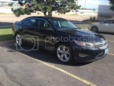

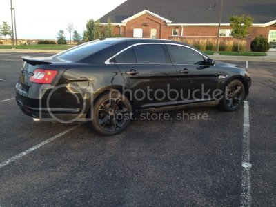

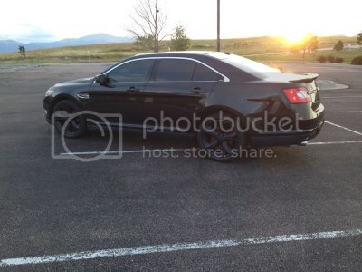

I'm definitely going to dip the window trim and side emblems, I just ran out of patience the other day, it will be completely blacked out then!
As to the process, it was ridiculously easy. First you have to clean the wheel and make sure it's bone dry. PlastiDip goes on in coats, it sprays just like spray paint but it's rubber so the excess peels right off. I applied 5 coats to the wheels, waiting 10-12 minutes for each coat to dry. As long as you spray in a smooth, continuous motion, about 6 inches from the surface the PlastiDip goes on butter smooth. I watched a ton of videos on youtube and checked out the Dipyourcar site to see what was the best approach. Some people taped off the wheels with painters tape, some used index cards, some didn't tape off at all. After watching all the videos and all the different methods I decided not to tape anything off. Honestly, it worked perfectly, all of the excess either peeled off easily or rubbed right off with a microfiber towel. I was skeptical at first but for 7 bucks a can how can you wrong trying, if you don't like it, peel it right off. It took me 2 and a half cans to do the wheels, grille, tail light trim, and back emblems.

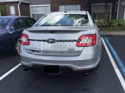

I plasti dipped the peeling chrome around the tail lights and also did my wheels about 2 months ago. I didn't remove anything prior to doing them, and the prep time was minimal, maybe 3 or 4 minutes per wheel. The reason I didn't paint them is I wasn't sure I would like the look of it, and I'd like to easily be able to remove it if I want. I love the look of both, and it also did extremely well at hiding curb rash that I had on my wheels (previous owner not me!).
I also did the chrome around the windows, but the edge wasn't good enough for it to come off cleanly, so I ended up removing all the dip and had it back to stock in 5 minutes. I think anyone that is dead set against plasti dip probably just has not ever used it. The crap is amazing considering the price.
My wheels took a total of 15 minutes prep time and $25 bucks in plasti dip and turned out looking professionally done. Not having to look at the cheap peeling tail lights is priceless as well. If I had a paint gun, I would spray my entire car flat black.
