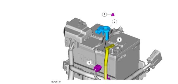

Don't connect the trickle charger to the negative post??? Then how is the battery going to charge if it isn't connected to the battery post? Also, I read in here recommending removing cables from the battery when trickle charging. What's the point of that? I've been trickle charging motorcycles for years using an auxiliary cable I plug into. Thanks for the clarification.
Read this thread it explains why our vehicles need to charge in a specific way. Also watch the YouTube video posted.
When charging, connect to the positive post and a good ground. The battery is grounded and will make a complete circuit. This allows the BMS to see the current flow.
