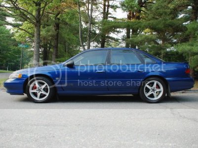

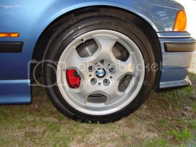

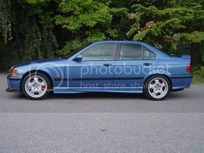

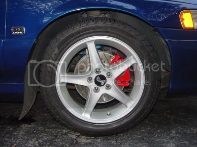

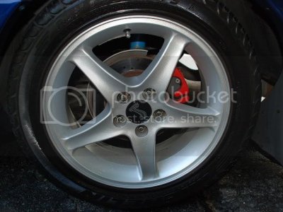

I have done both My SHO and BMW with G2 caliper paint kit, this is a 2 part system, the paint and catalyst, the kit comes with brake cleaner and acid brush, I found the best way to do this is to put the car on 4 jack stands with the wheels removed, disassemble all 4 calipers and clean them with the brake cleaner and a wire brush, once clean remount the calipers back on the bracketa without the brake pads, You will be able to turn the steering wheel for better access as well, I tried the hanging method but does not work well after the first coat when you are trying to move them aronund and the paint is still wet. Start at one caliper and move on to the next and so on, by the time you are done the forth one, the first one will be dry enough for the second coat, then proceed around the car again in the same pattern for 3-4 coats on each caliper, Let dry over night and reassemble, you will be very happy with the results. The next best thing to having them powder coated. It is available at The Eastwood Co. http://www.eastwoodco.com/shopping/..._SE-_-Google-_-Paint-_-G2_brake_caliper_paint

it got up to 43deg here today and i did a quickie wash with a brush on the end of a water hose. thanks for the pics Shota15 because when i stood back i imagined silver calipers or red and my first inclination is silver because it matches and isn't gaudy but red says look at my brake upgrade and "redneck" boy racer. i'm sitting on the fence right now. i want to keep the stock slicers. the cobra wheels look nice (but i have a set on my '03 cobra).
thanks for the responses and keep the pics coming guys! TIA
