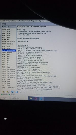

Hey guys, I have a code that keeps coming back from time to time and I'm not able to find the cause. I read some threads from other people on the forum and I feel like I have verified everything. I no longer have a catalyst. the downpipes are tight and not likely to leak. the code started to appear when I removed the catalyst and yet I put j for the o2 sensors. do you have any idea what is causing my problem?

This is the code

yes I informed myself before making the post. I feel like I've checked everything and was wondering if anyone could help me.
There are a few peeps here that can give you some ideas. Just trying to add to the kb of the discussion for what I can contribute for now.

based on the recent mods and the info @kryptto provided my money is on the EGR system. I would go back through it with a fine tooth comb and ensure all your connections are made and nothing is loose or melted. also worth checking the EVAP since I have recently learned that is a silent killer and is also on the list of probable causes.

I just saw that it could be the egr system. I'm going to check this further. I checked almost everything on the car but I noticed that the code says air fuel imbalance bank 2 on the sctx4 . I checked and the long term fuel trim on bank 2 is at 24.9% when I check the code on forscan. I checked the sparkplugs and it seems correct but I have the impression that it could be a faulty injector.

Forscan an invaluable tool, those plugs look fine - if the injector was going bad - just thinking out loud not declaring anything specific - could the injector be fine - the plugs look normal - if it was faulty wouldnt it show signs of fouling?
that's what I think too but the code appears more often than before that's why I think it's something mechanical but the car runs fine
