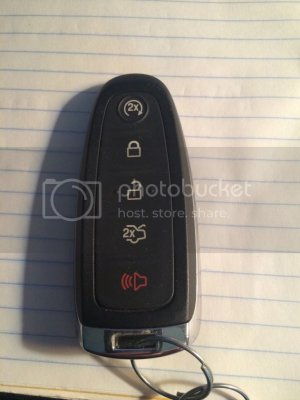

Just to add a picture since everyone loves pics...
If you have this style remote, you only have one battery. I took mine apart last night to check.
