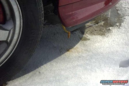

I used a spring loaded brass 3/8 check valve mounted upside down.
Before I made the self draing one I would get about 300ml a week of about 300 miles driving. really depends on the ambient temp. The hotter it is the more moisture in the air.
Here's a picture of it draining when parked for awhile last winter.
