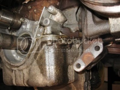

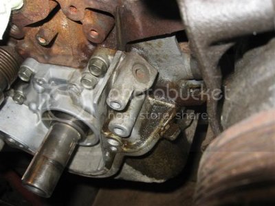

It's unlikely that volume of oil could come out of the oil pan seal. The oil pan is not under pressure, so any leak there would be modest. There are two nearby possibilities. One is the already mentioned front crankshaft seal. The other is the oil pump to block gasket, particularly on the right hand side of it where the pump output is. Hopefully, it's the easier to fix crankshaft seal. Since it's leaking so badly, you should check to make sure that something is not causing the crankcase to be pressurized. You can do that by disconnecting the PCV hoses, a big one that comes from the V in the block and goes to the bottom of the throttle body, and a smaller one that goes from the front valve cover to the throttle body. You can also loosen the oil fill cap. If the leaking stops once you do that, then something is causing pressure to build in the crankcase and forcing oil past the seal.
The pictures show the oil pump, the aluminum colored piece bolted to the block. The crank pulley and timing belt have been removed. You can see the crank seal, it is where the crankshaft passes through the oil pump. In this photo, you can see residue from a leak at the oil pump to block gasket on the right hand side of the pump. It's not a bad leak, and you can clearly see the oil is coming from there and not the crank seal in this example.
IMG 2121Small
IMG 2140Small

right there

It's going to look like the oil is coming from there no matter where it is leaking on the front side of the engine. I would pull the timing cover to see where it is actually leaking from.

It's not oily anywhere above there
I went ahead and ordered the pan gaskets/seals and rob bearings earlier.

You aren't going to lose that much oil that fast with just that gasket leaking. But its not my car or my money.
