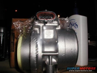

Click for full version:
P1101163
P1101164
Can we discuss...
A brand new Ford part, in an aftermarket box? I bought a brand spankin' new Ford MAF sensor AND housing...
...for $30.99!!! :hdance:

For all those that are looking for the site we're talking about... that'd be akin to posting a link for an eBay auction for a mint Gen 2 that I'm winning for $1.
So sorry, no link for j00.
But, I will go on to say that the site that we're finding these parts from is a site that has been mentioned here on SHOForum in the not so distant past. In fact, I found out about it on SHOForum. And I'm sure I'm not the only one shopping there, ergo the post above. :)
