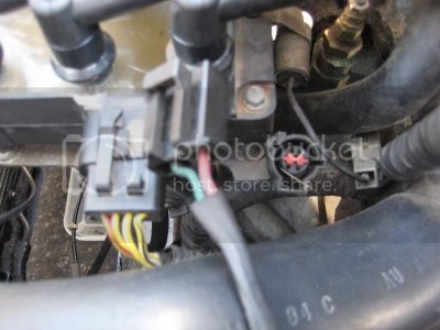

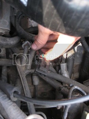

Okay, does anybody have any idea if any of these connectors would be causing any of my problems? Or better yet, what do these connectors do?
This one is sitting right by the rear head/valve cover. I don't know if it's ever been connected.
IMG 2756
This one I THINK goes to the cruise control, which was removed, so I'm not too worried if that's what this connector actually is.
IMG 2755
This is the one I'm kinda confused about, but chances are it wasn't plugged in when I bought the car so who knows :shrug:. (It's the one a little off-center to the right that you are looking straight into. Just to the right of the coil)
IMG 2754

The first one is not used.
The second one looks to be the solenoid purge valve (not really needed..)
And I think the last one is the cruise control.
Check to see if your'e getting 12v (B+) at the Red/Grn wire on the coil pack. It's also on the CPS, CID, DIS, and one other thing IIRC.
