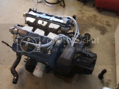

At the back-up light switch on the tranny. It's right next to the clutch cable, close to the frame, and has a two wire plug.
EDIT:
If you look at the eye hole for the clutch cable, follow it right, and you can see the sensor on the edge of the trans.
