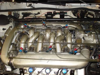

I have two sets of copper plugs left over from my sh!tstang. (there new) I was looking at just doing a cheap easy dry shot but if I can find a wet kit for not a bad price I'd like to do that insted. I have a 3.2 so will it be ok for fuel besides the pump I'm putting in a 255?
A wet kit for a SHO is pretty complicated. It has to be a direct port setup, If you use any other setup with a wet kit, it will puddle up in the intake runners and you will destroy the engine. Here is a picture of a direct port wet kit:
DSC01756
This is why people use the Zex Dry kit, As a Direct Port wet kit for these cars can cost nearly 1,000+. The 255 LPH pump will NOT work for your car unless you get a aftermarket Fuel Pressure regulator. Josh @ shonutperformance.com sells them.
If you want to keep it Cheap, Do this:
Zex kit 82011
155 LPH Fuel Pump.
Autolite 3923 Plugs
Run from a 50-100 shot and have fun.
