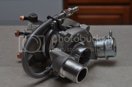

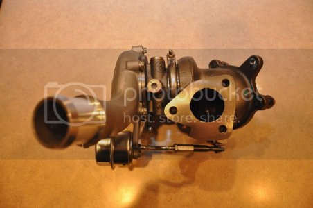

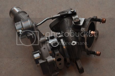

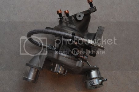

The new ATP +2 Turbos were delivered to my doorstep this past Thursday, October 17th, 2013 compliments of FedEx!
I think these are the second set ever to have been released. The owner of the 1st set, 4DRHTRD, who owns a Ford Flex, and lives out in AZ, put down OVER 600awhp with them.
I honestly likely will NOT be tuning my SHO anywhere near as aggressively as his set up (keeping in mind he's running other mods) but the potential is there to do so, and it's exciting to be part of the core group of Ecoboost enthusiasts who are helping facilitate getting these power plants to the next "stage" in their performance potential.
These turbos constitute a true "full" upgrade in the sense that the wonderfully talented staff over at Advanced Tuning Products (ATP) have gone through the painstaking expense of upgrading, and enlarging BOTH the Compressor AND the Exhaust Wheels.
They have also upgraded the seals throughout, installed a better wastegate, and the biggest factor, they've completely reworked the entire center portions of the turbo, implementing a ball bearing center.
I believe there are now a total of three companies out there that are selling upgraded turbos, but ATP is the only one at this point, performing a true upgrade as outlined above.
The other two companies have only performed limited aspects of an upgrade.

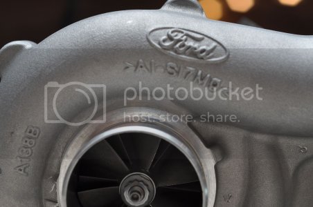

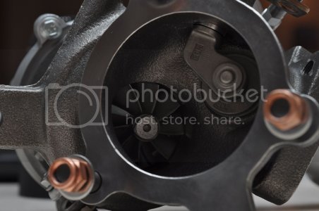

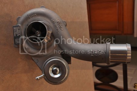

So here's the video of the turbo unveiling (thanks to my youngest daughter for her handy camera work) ------>
[YOUTUBE]EPQdnMbd_4c[/YOUTUBE]

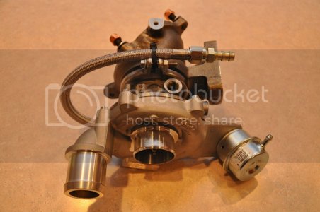

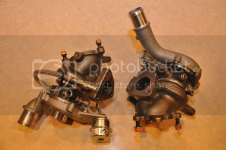

Along with some timely stills/snapshots for each of you to feast your eyes upon:
DSC 0001 zpsf67557f4
DSC 0002 zpscce135ad

So, I am tentatively slated to install these tomorrow, Monday, October 21st, 2013.
Pretty damn excited to say the least.
Hopefully more videos, and faster times just around the corner. :omgsho:

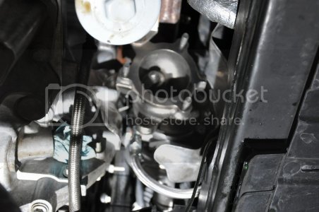

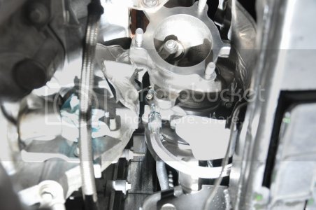

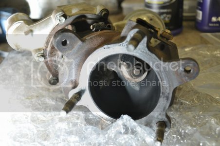

He had the front OEM turbo already removed, and the new ATP Upgraded Turbo installed in it's place.
He was working on the rear one when I arrived.
My pal commented that the front OEM turbo appeared "pretty tired" adding that there was oil coming from the main seal and the wheels looked less than desirable.
He said that was likely due to pushing the factory turbos beyond their designed capacities.
Nothing unusual really, just said it was "good" that these upgraded one's were going in their place.
So not wanting to be too much in his way, and knowing I still had to get my butt back home to grab me an afternoon power nap as I'm on shift again tonight, I opted to snap a couple of pics of my own.
My pal did say he took some pics on my behalf.... so I'll have to post those when the install's all completed.
Here's a few images of the factory turbo removed, a couple of the new ATP turbo installed, as well as the incredibly restrictive "hot" (pressurized side) of the piping/plumbing, and one or two of the factory electric BOV's.
Enjoy, now going to back to bed.

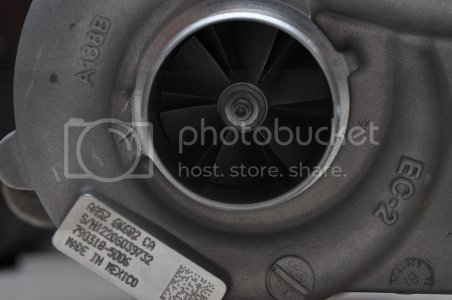

Old, Front, OEM Turbo Removed:
DSC 0002 zpscf09d71d
DSC 0005 zps93e8f5f8
DSC 0003 zps9e7033c0
______________________________

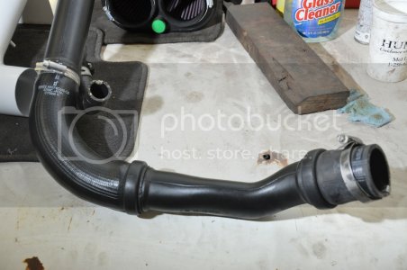

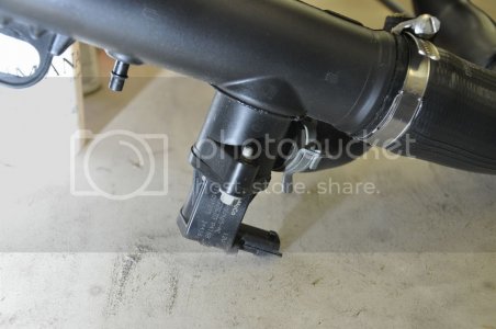

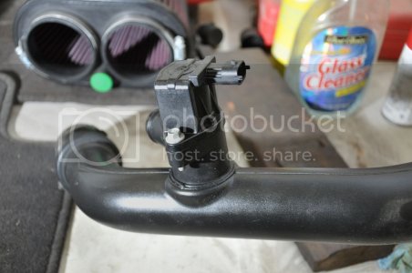

OEM "Hot" Piping and Factory Electric BOV's:
DSC 0008 zpsca3ac155
DSC 0010 zpsfbcb841b
DSC 0009 zpsfd7c228c

Thanks for the kudos!
To say the folks over at ATP did a tremendous job with these, would be an understatement.
Primary reason for going with a reworked, stock turbo housing is essentially lack of room within the engine compartment.
There is literally no room to place a larger housing/larger turbo in the locations where the OEM's are positioned in/on the block.
Additionally, as I stated previously, there are only three companies that I am aware of, that are currently offering turbo upgrades.
ATP is the only one of those three, that is performing a true, full upgrade, from "A-Z" so to speak.
More (tech related) info can be found here -----> http://www.atpturbo.com/mm5/merchan...oduct_Code=ATP-SHO-001&Category_Code=35V6TRAN
