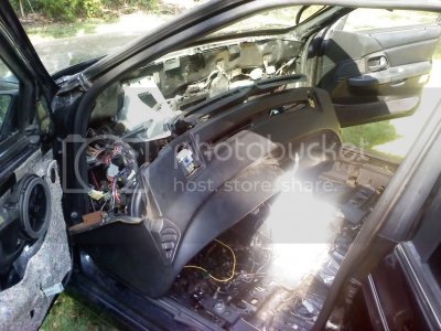

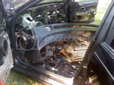

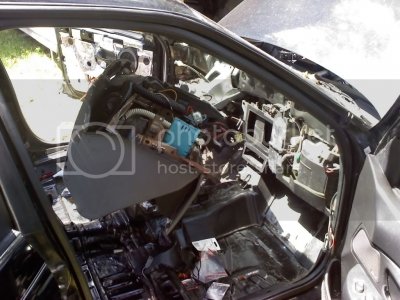

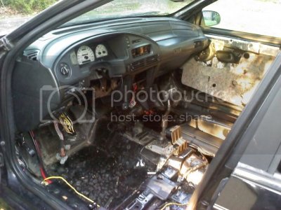

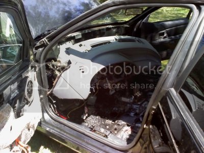

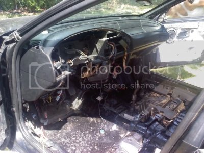

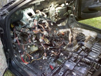

I am doing a full black interior swap at the moment and I'm at a crossroads and need a bit of help and/or guidance.
Ok first of all let me start by saying I didn't exactly do this to the book, and I'm pretty sure I made it harder on myself by doing so, but I'm past the point of no return and I need to get everything back together again.
When I was pulling my old dash out I did not pull the entire wiring harness through the firewall like it says to do in the shopheonixproject website, instead I took all of the wiring out through the back of the dash, while the dash was still in the car. so I took all the vent tubes and everything out and then basically had at it with the wiring. Finally got the dash out and so I'm putting the new dash in when I basically realize that I did it bass ackwards and its gonna be hard as anything to wire it back up and attach the vent tubes while the dash is in the car because there is very little clearance on anything and its not exactly the most comfortable thing in the world to be crammed halfway standing in that car while trying to work on the dash.
so my main question is which way should I go about this? should I just try and see if everything can go back in the way it is? or should I try to take the entire harness through the firewall and wire it up while the dash is outside the car?
thing is I tried to take the harness through the firewall before, wouldn't budge so I just gave up and did it the other way.
here are some pictures of how the progress came and where I stand on it right now (last pic)

and this is where I stand as of a couple hours ago
0723101603

see thats what I thought, but in the 5th picture down, that is when I disconnected everythign under the hood and thought I was ready to pull it through, but nope, did not budge at all. I was stumped so I did it the way I did it.
the main problem that I am stuck at now is that its just a PITA to get anything connected how it is, and I'm really stuck at trying to put up the vents that connect the defrosters to the windshield. there is no room to attach the (2) 7mm bolts that connect it at the bottom of the dash near the cigarette lighter/ash tray pull out thing.
