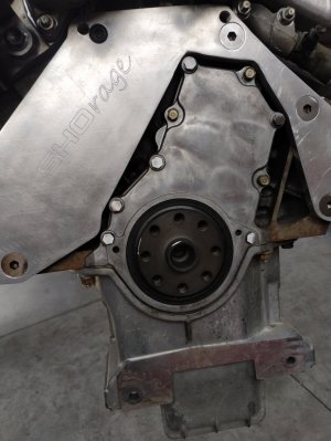

IMG 20250424 14594183399 For those of you still thinking about connecting a SHO to a RWD, wanted to let y'all know that thanks to a few folks from this community it may soon get a little easier. Here's the new Modern Driveline billet flywheel. These will be available retail once we are done.
IMG 20250424 15080433561 Up next, you'll want to check out the soon to be slightly modified for improved fit SHOrage adapter to the T5, which will pair nicely with a SBF bell housing...
IMG 20250430 164845744 Add a Powermaster starter, and you're set... Full parts list and "kit" details once we finish, but wanted to throw this on the forum incase anyone was starting to contemplate how they wanted to spend their summer!
Stay tuned - we should be getting the engine back from Modern Driveline in the next couple weeks and start fitting it in the Falcon.
