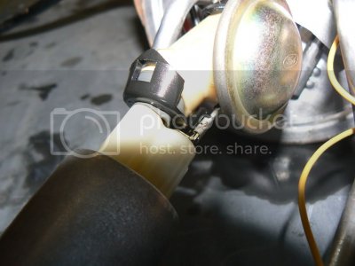

When someone I know... :) (Hi Mikey) :) Replaced his FP they didn't get it seated in quite right.. and he had similar problems. This is what I found when we cracked it open..
P1050940
That little gap is enough... make sure its in there "square". I had to bend it out a little to pull the old pump out, and kind of bend it back, but she's been working fine since.

Yes, I used all the new parts except for the fuel hose and clamps.. still have 'em.. and I made sure the clip was seated and it looked like that pic with the exception of my clip being clicked in on both sides...

No No.. its gotta be there.. it just came undone at some point, or it was never put in right in the first place, but that caused the same type of issue.
I think those things fit a little loose, but they appear to work I dunno?
